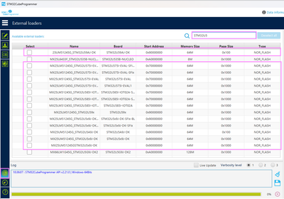

Hello @Harp0309 and welcome to the community;
You can find the external loader (.stldr) files for STM32U5 boards with OctoSPI NOR FLASH memories in STM32CubeProgrammer toolchain.
Also you can find some projects source in stm32-external-loader/STM32U5x_boards at main · STMicroelectronics/stm32-external-loader · GitHub.
I advise you to look at this How to implement and use your own external flash loader: An example using STM32U5A9J-DK may help you.
Thank you.
