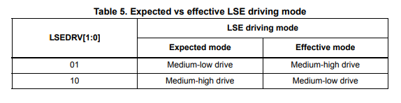

Hi @Community member,
Checking STM32H750 and STM32H743 errata sheets, there are mainly 2 LSE related limitations:
Please make sure that you are applying required workarounds for these limitations.

2022-11-08 3:38 AM
just my 2 cts : we had also problems with start of H7xx , when drive level of LSE is low (default);
so we set drive level high (or medium high) , then all running as they should . (about 500 boards now..)
2022-11-08 5:05 AM
Hi @AScha.3 ,
Based on this table from the errata sheet, LSEDRV should be set to "10" to be in the low drive as effective mode.
-Amel

Thanks everybody for your answers.
I did check errata and saw the issue about LSE driving bits swapped. I also noted in the STM32H7 cube library that the macro to set oscillator driving capability checks device revision and the swapped bits only apply to revision Y, I am using revision V. However, the errata document makes no mention of variant and suggests this issue applies to all revisions???
