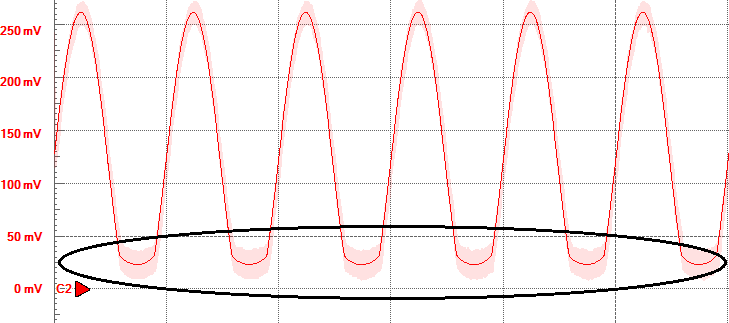

I am generating a sine wave by DDS method, but I dont know why the signal is flattering at the bottom. Does anyone have any idea why is this happening.2014-08-08 7:32 AM
Look in the DAC section in the data sheet for your device. You will probably find that the DAC buffer amplifier is not rail to rail. The same problem will exist if the output is programmed to go to VRef+.
An unbuffered output can come closer to the rails, but the current drive is meager, usually requiring input to the high impedance pin of an external op amp. Cheers, Hal2014-08-08 11:50 AM
Great that was helpful.... :)
