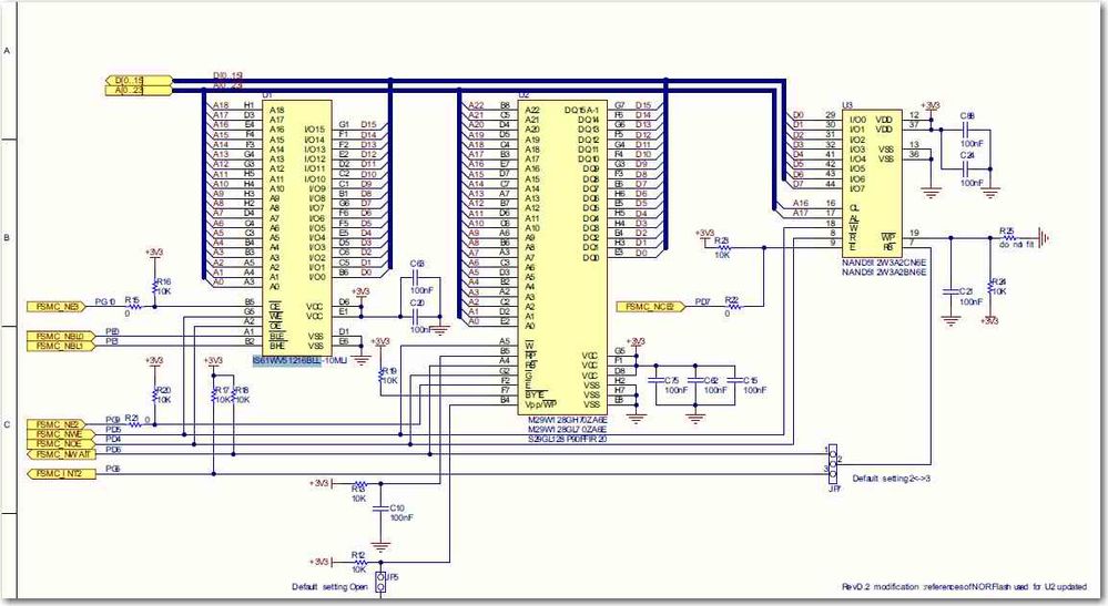

Look at the STM3210E-EVAL, and add more high-order address bits.
2014-04-22 7:51 PM
this one ?
2014-04-22 8:27 PM
what's the different between 512 x 16 and 1024 x 8, does it matter or the different is per word only ? can I use STM32 with x8 ?
The 16-bit wide ones would give you better bandwidth, I suggested a schematic based on the part you specified, for the 8-bit you'll have to source your own. I believe it should support 8-bit parts, review the documentation.2014-04-24 9:59 PM
