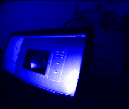

Look like happy implementation, code is running, no overflows found,but no data at the same time in sram
2014-10-23 11:46 AM
ok, find one mistake:
HSYNC and VSYNC polarity should be low instead of high. (confusing name) so now my old DMA based program does copy data, now i have to deal with switching DMA address for new offset. I can't found example how may registers i need to rewrite to make efficient DMA program inside line interrupt. ( i mean, should i just write new address inside pointer, or should i do more) It shoul work with double mode too, simply by seting dma to circular mode, and in main program just keep pulling when transfer is done, and switch to another pointer, but i can't found any example how to do it. so i made my program like this :void DCMI_IRQHandler(void)
if(DCMI_GetFlagStatus(DCMI_FLAG_VSYNCRI) == SET)
VSYNC++;
LINE=0;
else if(DCMI_GetFlagStatus(DCMI_FLAG_LINERI) == SET)
DMA_DeInit(DMA2_Stream1);
DMA_InitStructure.DMA_Memory0BaseAddr =(uint32_t) (FMC_SRAM_ADDRESS+2*LINE*1024);
DMA_Init(DMA2_Stream1, &DMA_InitStructure);
DMA_Cmd(DMA2_Stream1,ENABLE);
LINE++;
else if(DCMI_GetFlagStatus(DCMI_FLAG_OVFRI) == SET)
OVF++;
DCMI_ClearFlag(DCMI_FLAG_VSYNCRI);
DCMI_ClearFlag(DCMI_FLAG_LINERI);
DCMI_ClearFlag(DCMI_FLAG_OVFRI);
Highest address pin does corresponds to correct FPS number, so maybe it is correct.
Tomorrow i will try to make labview program so it could copy data to computer and show it, will see do i have any problems with image shifting, and so on
If any one knows how to make DMA based program more correct, let me know ( code sample helps alot)
