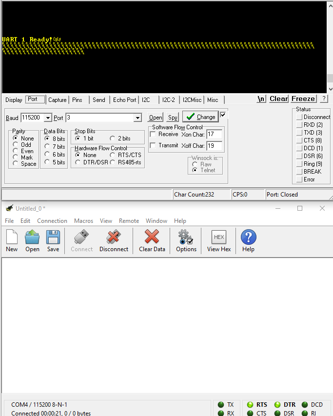

Hi, thank you for your reply. UASRT1 is hooked to the VCP which is outputted via CN14 (the USB STlink). It's not working cause there is nothing being outputted.
I just used a multi meter to test for a signal. I hooked up an esp8266 which outputs in serial and found that there is a voltage drop when there is data being transmitted. I then checked the data line (STM32 Tx on the STMod+ to Rx of the serial USB). There was no voltage drop. So I'm assuming there's no data being sent. I have also attached two pictures showing the output from the serial consoles. The top console is the STM32's serial while the bottom one is the output for the serial USB.
Note: I added a test string to UART1 to test that it's working properly
2021-10-18 8:23 AM
Please ignore that the port for the top serial console is closed. I turned it off before I screenshot the images
