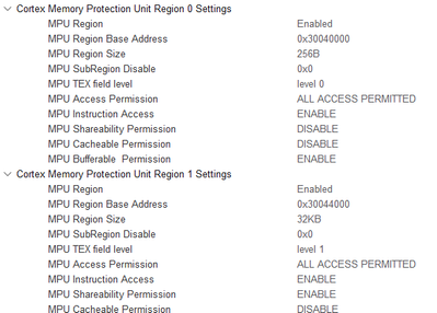

So, my settings looks like these:

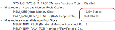

LWIP settings:

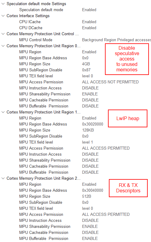

2024-09-07 5:42 AM
Probably an issue in the LWIP heap memory region:
I suggest you to check again the MPU config (Bufferability, Sharability, Cachability and TEX level) as described in https://community.st.com/s/article/How-to-create-project-for-STM32H7-with-Ethernet-and-LwIP-stack-working?t=1679361727348:
