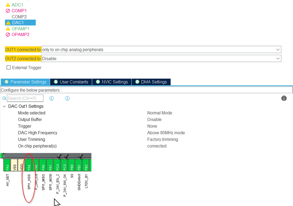

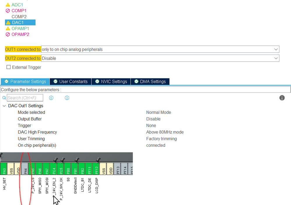

The DAC # is 1, the only DAC in this MPU, Channel is 1, OPA# is 1, GPIO is PA4, exclusively designated to DAC1 channel 1. OPA output is on PA3
In my IO-setting, I need PA4 for its function as 'spi1_nss'. For my application, I like to lower the output impedance of the DAC. So, two flies in one catch. Use the OPA as a follower, and free PA4. The strange thing is, this is working OK when PA4 is in reset state. So the DAC is feeding the OPA, and the OPA is conveying the votage 1:1 to output PA3. When I set PA4 to 'reset state' the setup is working as expected. When I set PA4 to an output, or SP1_NSS, the voltage on PA3 does not follow the value set to the DAC. Checking the settings of the DAC and the OPA in the debugger shows exactly the same values in both situations.
When I have PA4 in reset state, and it is working as desired, I can change the state of PA4 in the debugger by modifing the two MODER4 bits. In reset state it is 3. With every other value, the output value of the PA (PA3) is immediately lowered to 0,3 V. When changed back to 3. the desired value apears again.
Pic 1: Desired situation, not working
Pic2: Situation that is working:

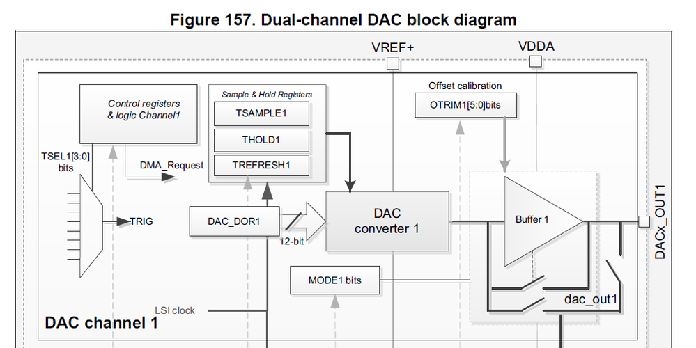

22.7.16 DAC mode control register (DAC_MCR)
Bits 2:0 MODE1[2:0]: DAC channel1 mode
These bits can be written only when the DAC is disabled and not in the calibration mode
(when bit EN1 = 0 and bit CEN1 = 0 in the DAC_CR register). If EN1 = 1 or CEN1 = 1 the
write operation is ignored.
They can be set and cleared by software to select the DAC channel1 mode:
– DAC channel1 in Normal mode
000: DAC channel1 is connected to external pin with Buffer enabled
001: DAC channel1 is connected to external pin and to on chip peripherals with Buffer
enabled
010: DAC channel1 is connected to external pin with Buffer disabled
011: DAC channel1 is connected to on chip peripherals with Buffer disabled
Also read Errata, there is DAC paragraph.
