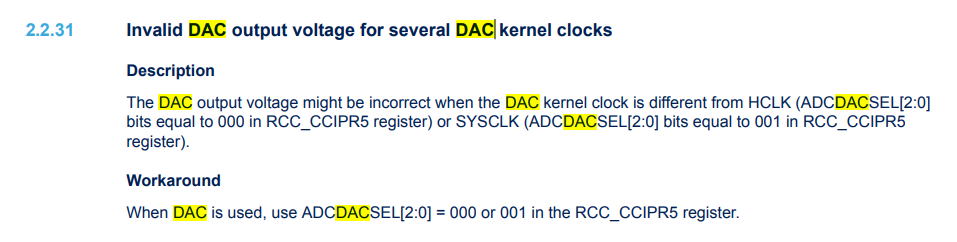

2025-01-10 8:39 AM
Hello @jeremierafin ,
First of all, I wanted to thank you for your detailed explanation and outstanding detailing of this issue.
after examination of the code and after double-checking the tests that you did i share your assumption about this being a silicon bug most probably related to the STM32H562xx/563xx/573xx device errata - Errata sheet
I submitted a ticket (ticket number 200203 for internal reference only) to confirm this erratum is valid for H523 series as well and will keep you updated.
Regards

2025-01-21 1:48 AM
This has been confirmed as limitation and will be updated in upcoming Errata revisions. Thank you for pointing this out.
Regards
2025-01-29 2:34 AM
To conclude: the DAC CAN NOT be clocked by PLL2R (silicon bug).
