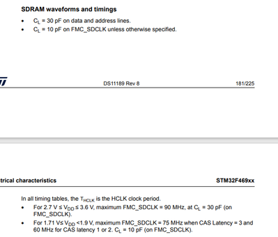

KDJEM.1
Hello @RobNewbury ;
Please make sure that the SDRAM clock frequency does not exceed the maximum supported value. You can fin the maximum FMC_SDCLK in the datasheet.
Also, I recommend you to start with verifying SDRAM timing and LTDC configuration, then proceed to signal integrity checks.
For that, I advise you to AN4861 for detailed recommendations on LTDC and SDRAM configurations, including optimizing framebuffer fetching and addressing potential pitfalls
I hope this help you.
Thank you.
Kaouthar
