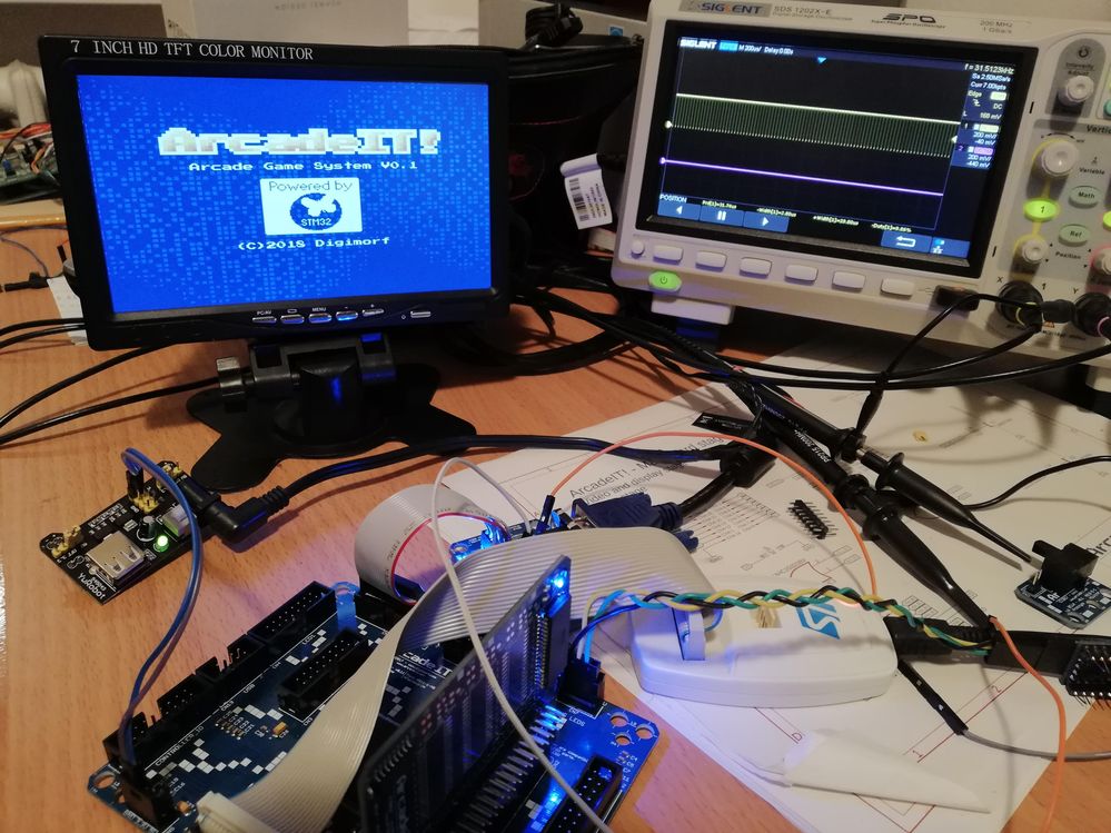

I am developing a custom board that mounts a STM32F469 MCU. The board is very simple, and the circuit embeds only the main 8Mhz crystal and the RTC 32.768 one. No embedded peripherals except for a couple of status LEDs and a MUX 74*138 chip used to select memory banks on an expansion BUS based on the FMC.
Crystals are more or less equivalent to the 469 Discovery, they are very close to the CHIP and the capacitors are the ones required by the crystals. ''Electrically'' speaking everything should be correct since the board works fine.
The board mounts several headers to connect peripherals, so I can say that this is a minimal STM32F469 system. I have developed many drivers for this system so far, SRAM on FMC, SD over SPI, Usart etc, now I am fine tuning a VGA driver. Each driver can be included or not at the startup, so, for now, I am fine tuning the VGA driver and in this specific case is the is the only one started in the project.
All the firmware at the moment is based on the Standard peripheral library 1.8.0, but I think to clean everything by using my own references to registers.

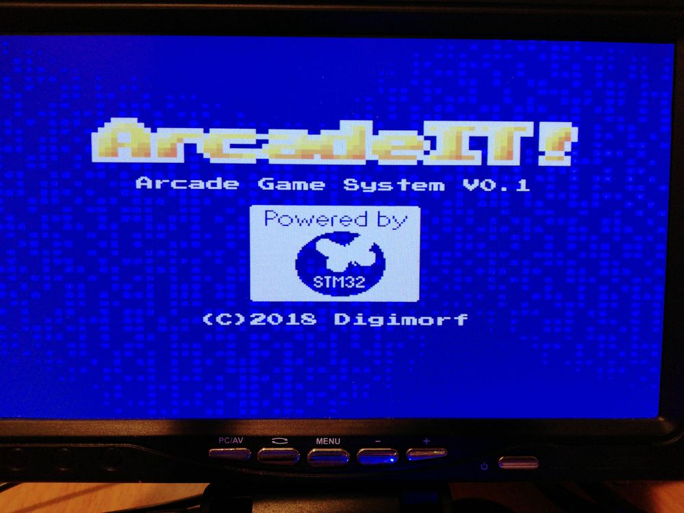

Anyway, the VGA driver uses an external 12-bit resistor DAC, plus two simple GPIOs for H and V synchros. The signal is generated by a DMA that streams a scanline n the GPIO port. This stream of data drives also the horizontal sync, so no PWM channel is needed for the hsync pulse. The DMA is triggered by TIM8 clocked at a pixel clock frequency very close to the VGA standard, so no problem with that. I can generate a horizontal resolution up to 640x480.

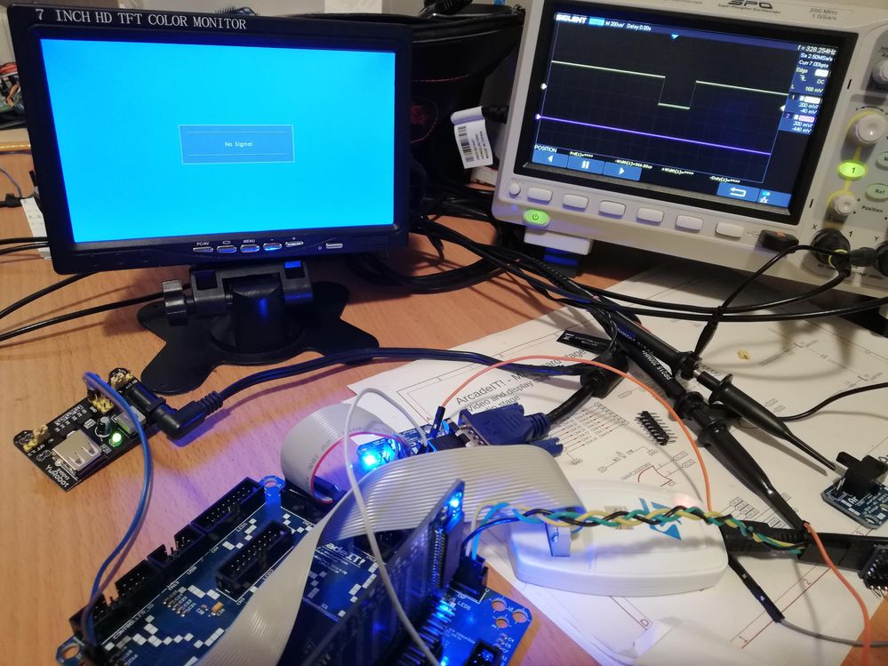

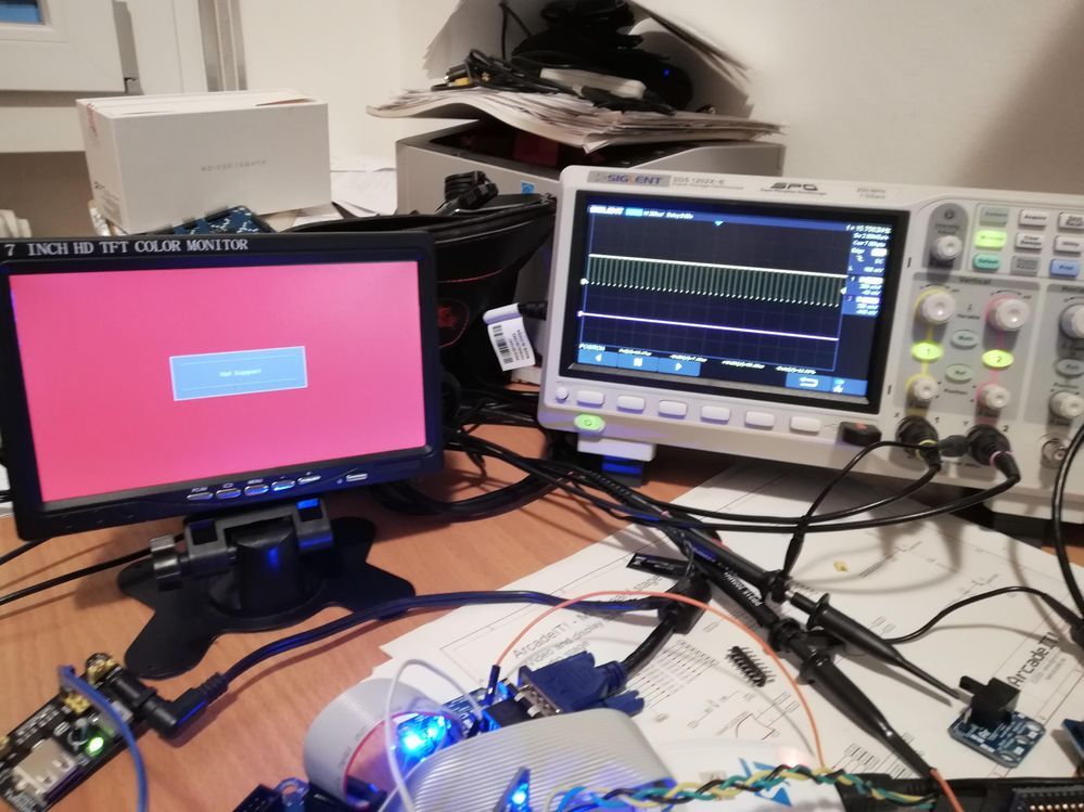

The weird problem that I am experiencing is that when I power on the board, the clock seems to run slower than it is supposed to run. The scan line, which is generated by theTIM8 that trigs the DMA, seems to take more time. BUT, if I push the reset button (this is a simple reset circuit with a pull-up resistor) the speed increases. Sometimes after the first reset it fixes and goes to the correct one, sometimes it needs more resets to adjust.
As you can see from pics, the monitor doesn't catch the signal until the third reset. Really weird.
If the clock wasn't properly configured the TIM8 shouldn't generate the signal at all, on the other hand, the circuit should be correct, otherwise, the clock shouldn't work correctly. It seems that the reset is needed to stabilize the clock.

can you try to increase the default software timeout of all HSE , LSE clocks before the Ready bit is set. Same for PLL lock as well. You should find it in the Clock setup functions. It may happen that with your selected crystal start-up it is a bit longer after power Up. When doing a soft reset the clocks may be stabilized and ready after the expired timeout.
