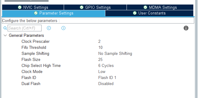

I am trying to create an external loader for my project by ST's "How to create an external QSPI loader MOOC" lesson. Actually lesson's github repository have microcontroller and quad spi flash configurations that I use. I just change some pin configurations for my board's need.
Although I do everything like lesson but my external loader doesn't work correctly. It load flash shifting a byte. For example if my first 4 byte is {11 22 33 44}, external loader is loading these bytes flash like this {22 33 44 xx}. My all data is becoming can't usable because of this problem.

}When I debug code with this, code stopped to last "while". My quad spi configuration like this;
Thanks for reply.

2021-02-22 12:46 PM
It's all pretty top-level superficial stuff.
You'd want to look at the commands being sent, the dummy cycle configurations, and the mode settings and expectations of the device, say quad mode, and 3 or 4 byte addressing.
I'd probably have 1-bit and 4-bit read operations immediately after the write to cross-check that works before doing the memory mapping.
Right now I have no idea what STM32, which pins, what QSPI Memory device are involved here.
Figuring a 256 Mbit (32MB) device, needing 4-byte addressing.
For the H7 I'd watch for the end-of-memory errata on the QSPI

I use STM32H743XI microcontroller and MT25QL512 quad spi nor flash. I am using exact same Loader files and quad spi drivers in this repository. Maybe these would be revealing
I will look up to your saying.
