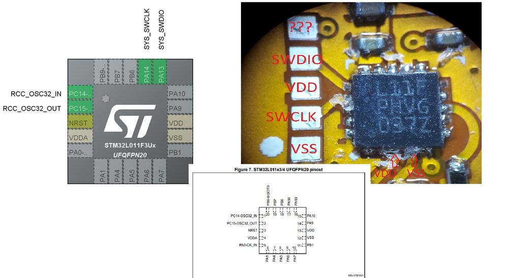

‎2021-02-21 6:05 AM
I don't know what to do, the chip in the picture has jumper inputs and I tried to connect with stlinkv2 using them. But it didn't happen. Also, there is a 5th jumper input that I do not know. What is it?
‎2021-02-21 6:27 AM
What board is this? Do you have schematics?
Could you probe the circuit for continuity? Perhaps it's NRST?
Is the chip powered?
Pin 1&2 of the ST-LINK/V2 don't supply power, but need to see the voltage the Target device is using.

‎2021-02-21 6:52 AM
I don't have a circuit diagram. I also connected the 5th jumper output to gnd and saw what in the picture.
So I have to remove pins 1 and 2 of st-link/v2 and connect my external power supply on the chip?

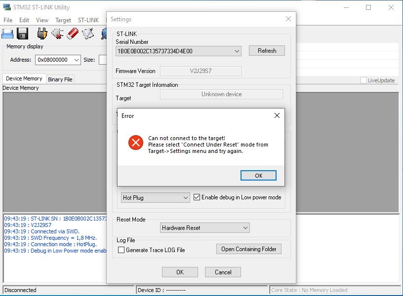

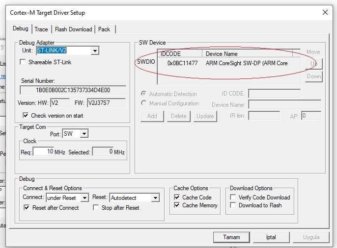

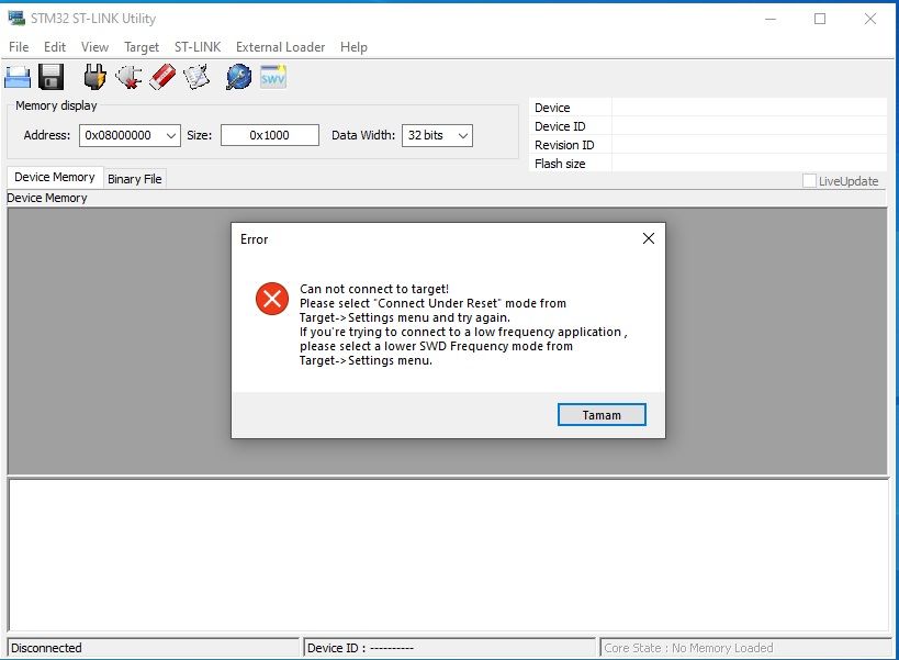

I'd probably get the Target Com Clock closer to 2 MHz for a CM0 part.
If NRST isn't connected "Connect under Reset" really isn't going to work/help
‎2021-02-22 10:41 PM
I did not understand them. Sir, can you make any assumptions about what happened by examining the two pictures?
