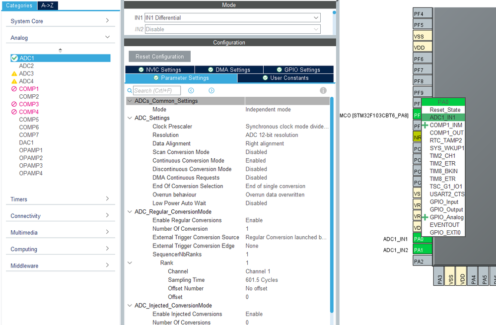

Here is an screenshot of my configuration and I also include the main.c code, but the only things that I've included after auto generating are:

What is common mode voltage? Differential mode has only a small window around VREF/2., see table 79 CMIR.

Common mode voltage is ( V(ADCIN+, referenced to ground) - V(ADCIN-, referenced to ground)). It seems your setup has no ground connection between Nucleo and "CAP" board, so common mode voltage is floating and perhaps strange things happen. Try to measure single-ended: Connect to lower vltage of the CAP board to MCU GND and the higher voltage to ADCIN. Read about common-mode, single ended etc also in the Internet.

No. ADC absolute voltage needs to be between VSSA and VDDA or you will fry the chip.
