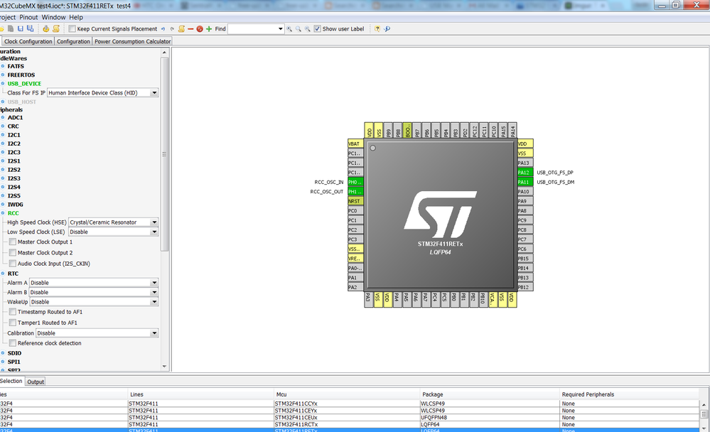

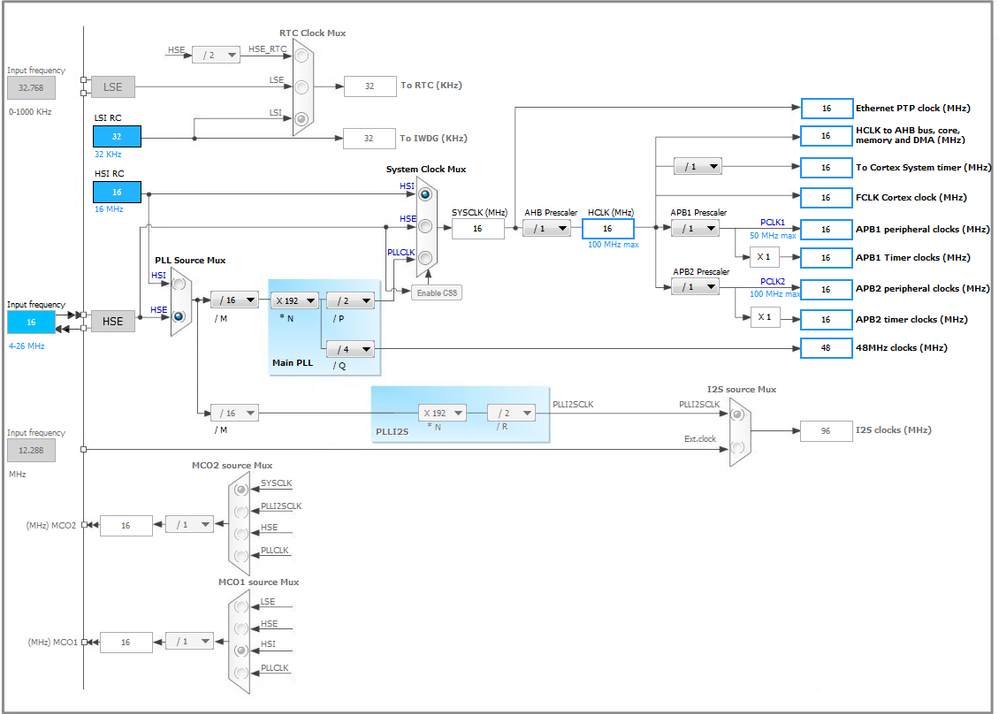

I have a custom board with a stm32f4 I am trying to use cubmx to generate a usb HID project but the generated code does not work. The board appears as an unrecognized device when I attach it to my computer. My board uses a 16 MHz crystal oscillator attached to PHI and PH0. Clock configurationI added a call to USBD_HID_SendReport in the while loop of the main function. supporting this was the only change I made to the generated code from cubemx.
Are there any other changes I need to make to the generated code to make this appear as an HID device on my computer?int

In
his figure
the
''System
Clock
Mux
''is set to ''
HSI''when it should be
PLLCLK''.
2015-09-23 11:53 AM
Hi Silvva
I switched the clock source.Now I am seeing this error message in the device manager which I have not seen before.This device is disabled because the firmware of the device did not give it the required resources. (Code 29)2015-09-23 11:53 AM
