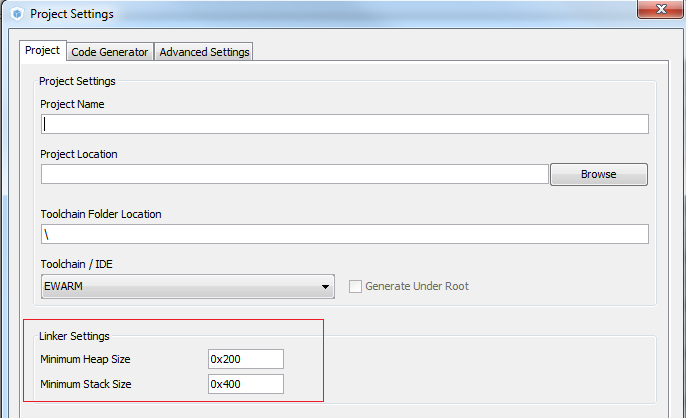

Is there an option for increasing these in cubeMX? I have tried increasing the stack size for the RTOS task allocated to USB and have also increased the heap and stack size within the linker configuration. I notice that whenever I rebuild the cubeMX project it returns the heap and stack size back to their default value. Is there a minimum heap size for the USB?

,Is there an option for increasing these in cubeMX?
maybe you can refer to USB example under the STM32CUBE F4 package : STM32Cube_FW_F4_V1.0\Projects\STM32469I_EVAL\Applications\USB_Device-Nesrine-

2017-01-24 3:19 AM
Thank you for your help
ELMHIRI.Syrine
, i increased the stack and heap sizes further and the device operates without a driver failed to start error which i was seeing before. The low power mode of the USB seem'd to crash the program, out of interest how would one implement the low power mode? is there a function which should invoke a power up/ low power mode enable?We’re moving the ST Community to a new platform to give you a better and more reliable community experience.
