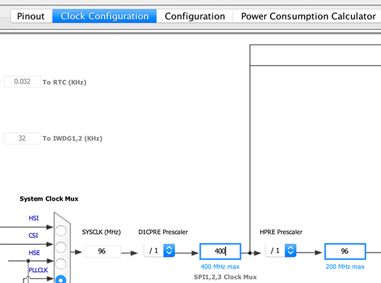

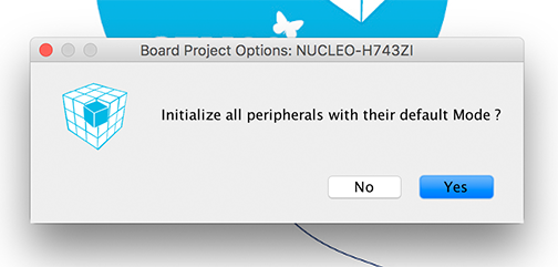

3.)
A new project with the button checked 'Initialize all peripherals with their default Mode'
will not find a solution if setting the clock to 400 MHz. Setting the dividers by hand works.
Solution: Uncheck USB_OTG_FS, because the clock solution process does not find a goal for 48 MHz.

2018-02-15 1:17 PM
Hi.
To reproduce #3 simpy follow this steps:
- Open CubeMX 4.24 (or 4.23)
- New Project
- Choose Board, select Nucleo-H743ZI
- Click on ''Start Project''
- Choose
- Then click the ''Clock Configuration'' tab and enter 400 MHz
It hangs in an endless loop, no solution will be find.

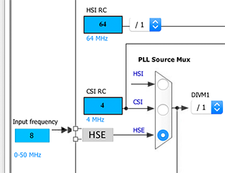

on the clock config in cubemx, what is the HSE input freq?
when i make project for that NUC board, the project default is 25MHz
But the NUCs use 8MHz MCO from stlink by default.
This burned my twice on Nuc-767 projects.
2018-02-16 3:26 PM
8, which is correct. We are talking about H743, not F767
You can try for yourself with CubeMX.
