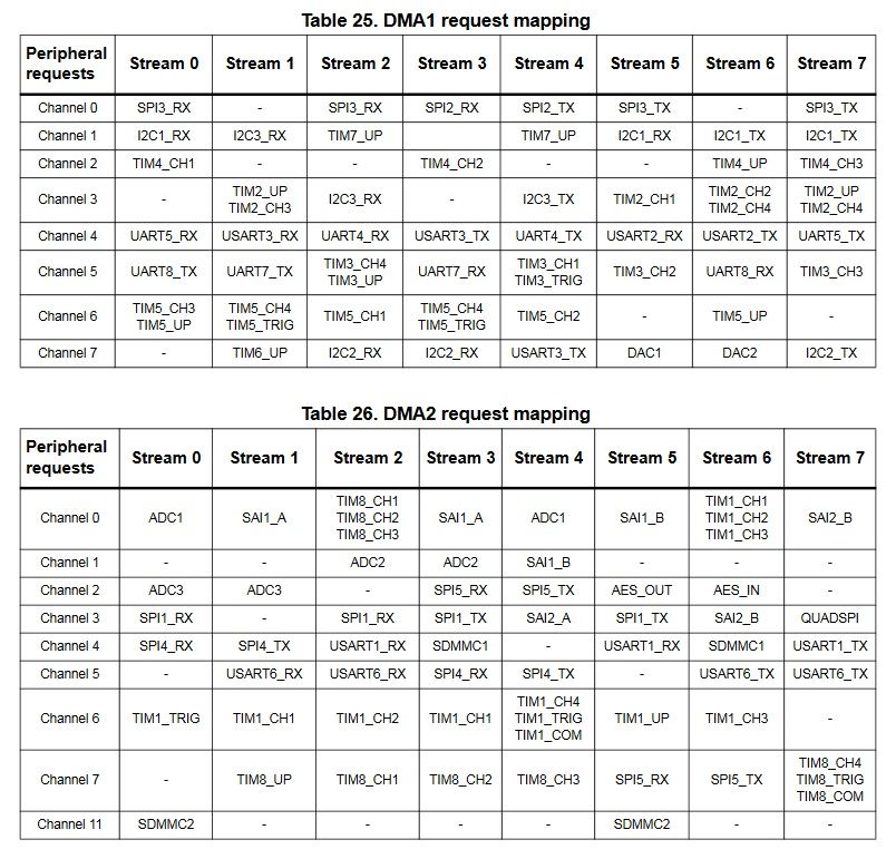

USART2 will be on DMA1, not DMA2
2018-02-16 2:29 PM
2018-02-16 4:05 PM
You are the man!!
I know there had to be that table somewhere. What document did that come out of? I looked in the data sheet for the STM32F722 and it's not there.
Thanks!!!
2018-02-16 4:27 PM
This is out of the Reference Manual (RM0431)
