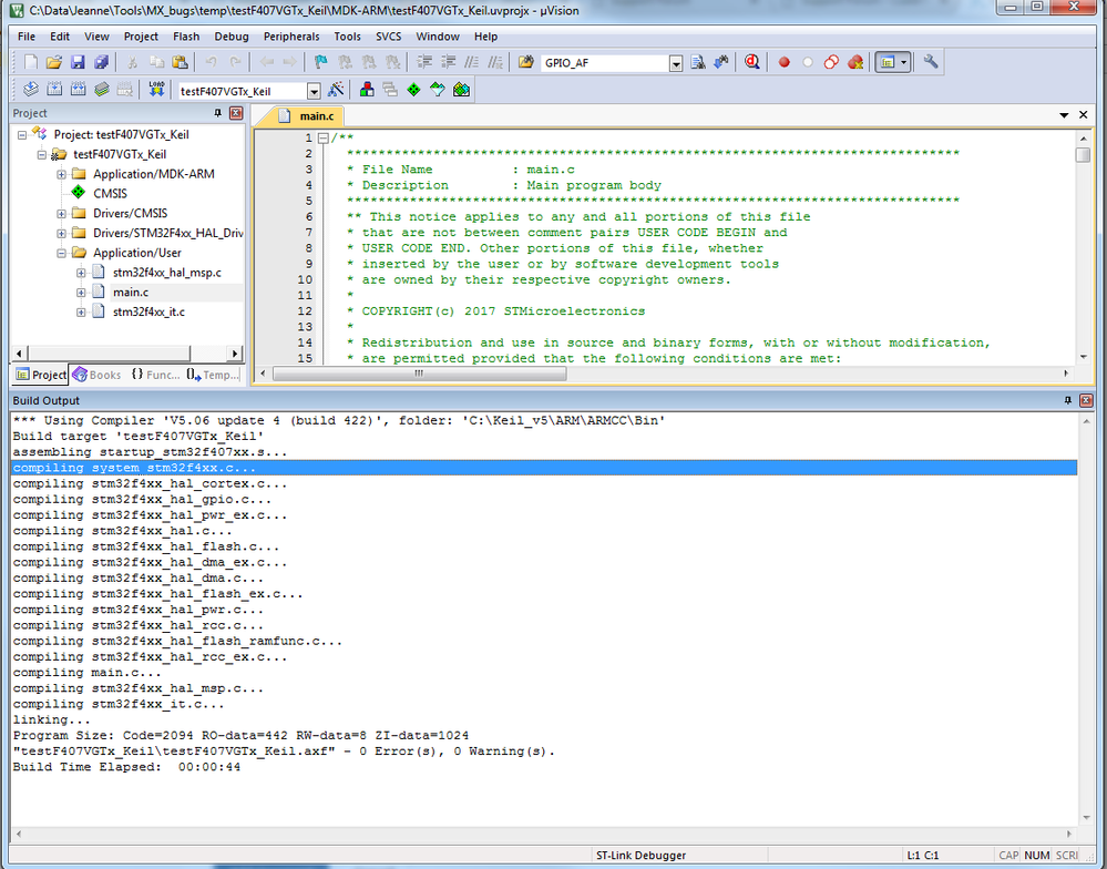

,Yes, there are 2 identical files (one in Src, the other in Drivers\CMSIS\Device\ST\STM32F4xx\Source\Templates).
However, it does not lead to any linking or compilation errors under Keil as you can see below :
If I miss something, don't hesitate to tell me.
BR. Eric
