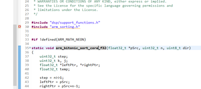

Hi :
I updated STM32CubeIDE a few hours ago.
Version: 1.15.0
Build: 20695_20240315_1429 (UTC)
Now it will failed at the SystemClock_Config() and missing arm_sorting.h

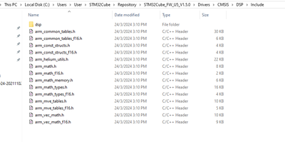

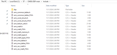

Hi @STTwo-32 :
I don't see any "arm_sorting.h" at both folders.
"dsp/support_functions.h" yes, the support_functions header file is in both folder.
is this what you are looking for?
Regards and Thanks
Simon
