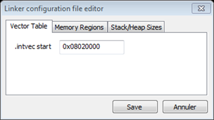

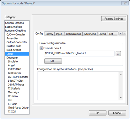

On the second example (that I want to load with IAP) I need to modify the project to start at 0x08020000, to do this I change this on IAR :
In file system_stm32f4xx.c I do this :
#define VECT_TAB_OFFSET 0x20000

The map generated with the linker :*******************************************************************************
*** PLACEMENT SUMMARY
''A1'': place at 0x08020000 { ro section .intvec };
''P1'': place in [from 0x08020000 to 0x081fffff] { ro };
''P2'': place in [from 0x20000000 to 0x2002ffff] { rw, block CSTACK, block HEAP };
