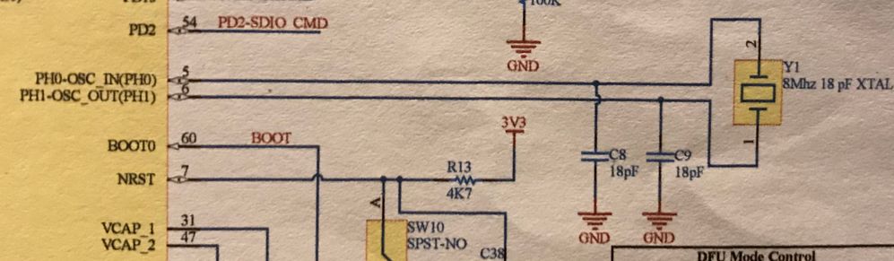

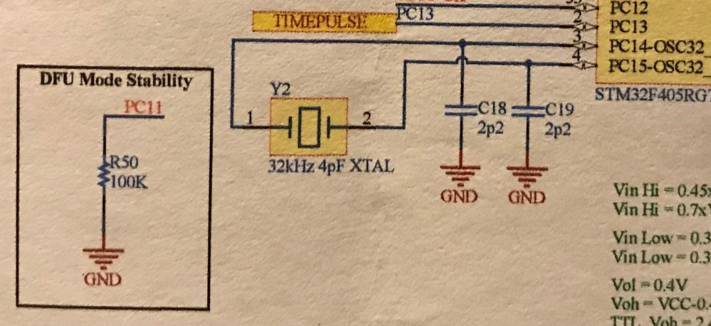

2019-07-28 5:06 AM
I have designed in the following oscillators:
Will these two crystals work in this configuration?
2019-07-28 7:11 AM
For correct capacitor values check out AN2867 and this:
https://blog.adafruit.com/2012/01/24/choosing-the-right-crystal-and-caps-for-your-design/
