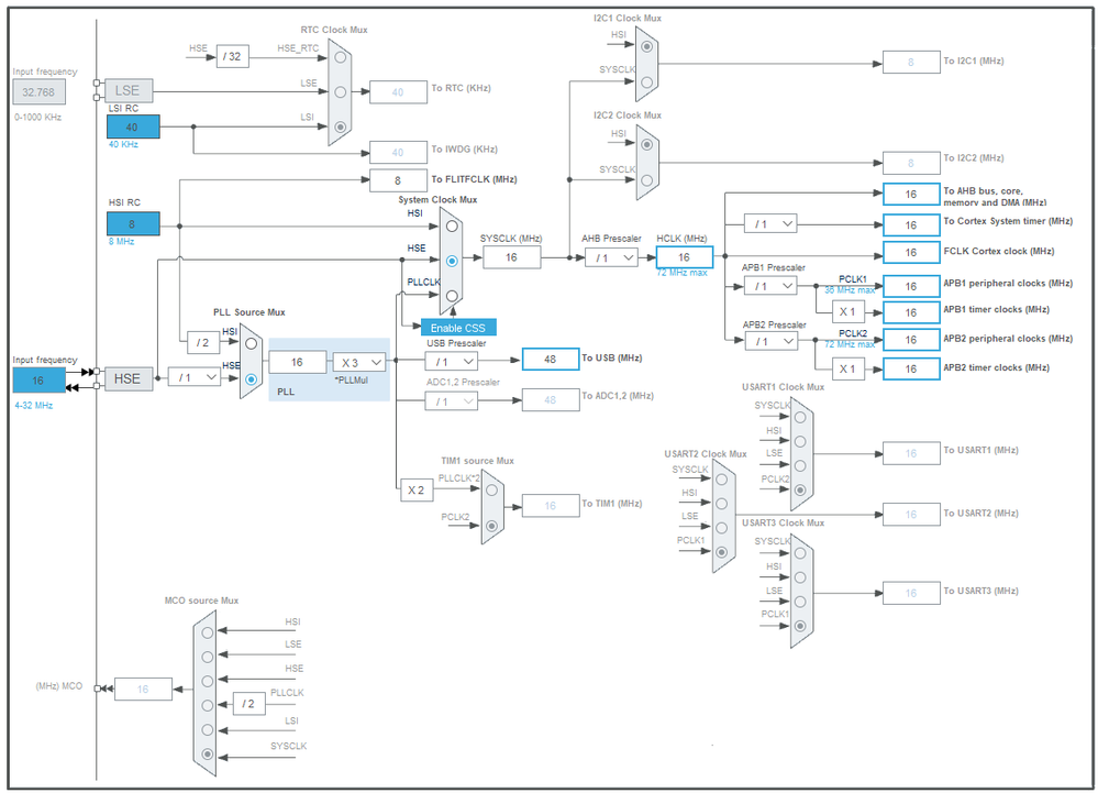

Hello all, I am starting a new project based on the STM32F302 MCU and I am running into an interesting clock configuration timeout issue that results in a fault during most debug sessions. So far, all I have done is configure the clock tree and enabled the USB peripheral as a virtual COM port.
I am using an external 16 MHz oscillator which feeds directly to the system clock. The USB peripheral clock is generated using the internal PLL x3 to 48 MHz.

Do any of you have any wisdom as to what is going on here? I have the same code running on another part number just fine.

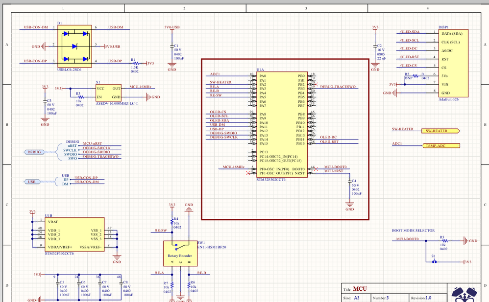

Hi TDK, thanks for the reply. Yes, this is a custom board, but the external oscillator setup is very similar to other boards I have made that work reliably. I have also looked at the oscillator output on an oscilloscope and everything looks good.
