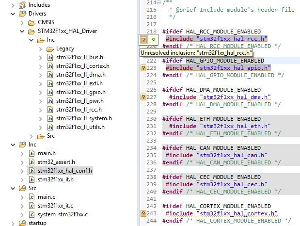

2018-03-06 1:28 AM
As an addition to the second question about including HAL drivers instead of LL drivers: a screenshot
No doubt I'm doing something wrong, but I can't find what....
