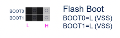

Hi @RomainR., Thanks for the info. What I am trying to do achieve is to put the STM32N6570-DK in the DEV mode with secure boot disabled so that BootROM can run the non secure application binary directly from QSPI flash available on this board if it is capable of XIP. For the initial development I would like to use minimal and simple setup as possible. My board is shipped with this BOOT configuration
So, can you guide me if my development setup as described above is possible with this board and CubeMX, if it is yes, how to do it please?
Note: I was using another vendor Cortex-M33 based hardware where this setup was possible to run the non secure app from the QSPI flash with XIP in the DEV and non secure mode.

Hello @ramkumarkoppu
As explained in my previous comment, you will not be able to execute a non-secure binary from the BootROM.
At the STM32N6 Life-Cycle level, all shipped STM32N6 are in a Closed-Unlocked state.
Look at the following KB: In section 4. Supported life cycle:
https://community.st.com/t5/stm32-mcus/stm32n6-boot-rom-explained/ta-p/763648
Moreover, the OTP18 fuse is by default already secure_boot=0. So In Dev_BOOT or in Flash Boot (XiP) your execution context will systematically be:
There is another example in STM32Cube_FW_N6_V1.1.0\Projects\NUCLEO-N657X0-Q\Examples\RIF\RIF_Peripheral
This time the FSBL (Secure) directly configures the RIF and jumps into a non-secure application (here the RIF authorizes the SPI)
