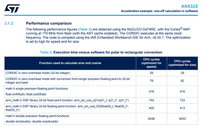

The AN5325 " How to use the CORDIC to perform mathematical functions on STM32 MCUs - Application note " describes some requirements of CORDIC and performance evaluation (section 3) of mathematical expressions (cos and sin) compared to an equivalent function from a software library such as math.h.
An example is provided in the STM32CubeG4 MCU Package, under \Projects\NUCLEO-G474RE\Examples_LL\CORDIC\CORDIC_CosSin. This example performs a polar to rectangular conversion using the cosine function.
For cos and sin, there is an enhancement of a factor from 5 to 10 can be reached in terms of speed when using CORDIC accelerator versus math.h and arm_math.h software.
Please try the provided example of evaluation in the AN5325. If you are still not convinced with materials and results inside, we need your software implementation of cos/sin to compare it versus CORDIC.

For cos and sin, there is an enhancement of a factor from 5 to 10 can be reached in terms of speed when using CORDIC accelerator versus math.h and arm_math.h software. But i am not getting the required result.
