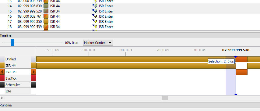

I have a NUCLEO-F429ZI board and am trying to get ADC1 to convert one channel (channel 3) when triggered by TIM2 (every second).
As I don't have an oscilloscope I wanted to measure the conversion time - to make sure everything is configured correctly - using Segger SystemView.
With the code below I set ADCCLK to 22.5 MHz and sample time to 480 clock cycles so I would expect the ADC interrupt to occur roughly 22 µs after the timer interrupt.
What I am seeing though is that the ADC interrupt (ISR34) occurs 2.6 µs after the timer ISR (ISR 44) (see screenshot).
Quesion: Why is the ADC interrupt so fast?

2020-06-16 12:18 AM
> // set channel 3 as first (any only) regular channel
> ADC1->SQR3 |= (ADC_SQR3_SQ1_2 | ADC_SQR3_SQ1_1);
Isn't this setting channel 6 rather than 3?
2020-06-16 12:18 AM
2020-06-16 12:37 AM
Yes, you are correct, that's the wrong channel! But does that really explain why the ADC interrupt occurs too fast?
I would have expected (without knowing for sure) the values to be different from the ones I would have expected but haven't even checked yet (as the input is not configured correctly) but not that the conversion is finished in a tenth of the time.
I can only try tonight as I don't have the hardware with me at the moment.
Best regards
2020-06-16 1:31 AM
How's channel 6 sample rate set?
2020-06-16 10:46 AM
Oh man, you are so right! It was - of course - set to 0 (its reset value) and therefore to 3 cycles. I will have to get used to this per-channel sampling time configuration and take even better care about setting the correct bits!
After setting channel 3 in register ADC_SQR3 I now get a conversion time - measured with SystemView - of 21.9 µs!
Thanks a lot for the help!
