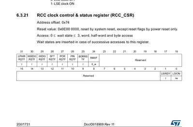

I think you need to reproduce the behavior at your desk / lab.
Then, check the RCC CSR register. Here a snapshot from the F40x manual :

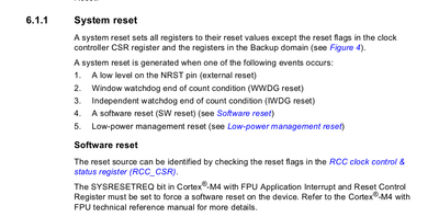

And here a list of reset causes, from the same manual:

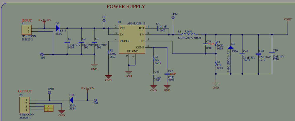

Please find the power supply design.

power circuit design
