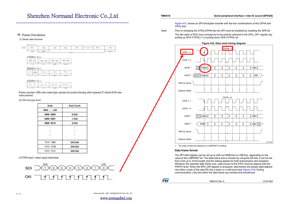

I need to control some SK9822 2020 RGB LED's.
I figured out that with the information on this website I can control them over SPI in transmitt only mode.

2023-05-10 5:29 AM - edited 2023-11-20 5:51 AM
This
and the maximum frequency (baudrate) are the only specifics to be set up in the STM32 SPI.
