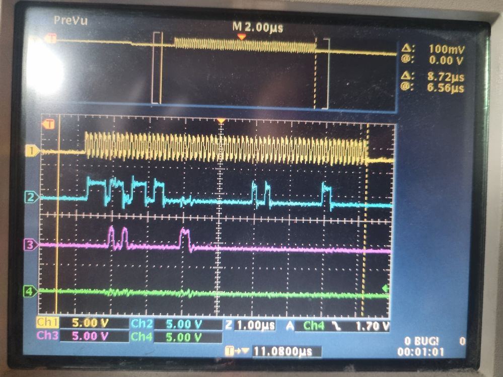

In fact, with bit bang, I get this:

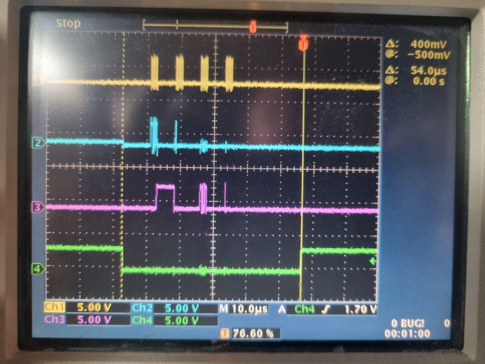

with Hardware SPI, i'm 54us, ...
I'm at a 54us frame rate, much better, but still not there. I configured the STM32CUBEMX to have an spi2 port with the CS (sync) pin as IO, but it takes a long time to respond...
Furthermore, my frames aren't close enough together; I have a latency between them that I can't reduce.
