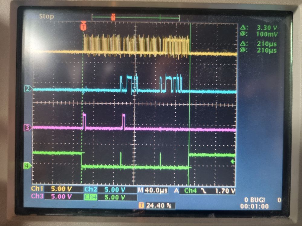

In fact, in bit bang, I get this:
With this code :

about 200us ...
