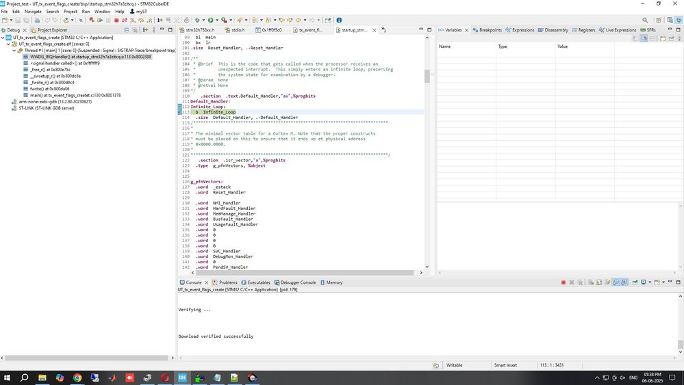

This happens if an interrupt fires that you don't have implemented in the code. You can look at VECTACTIVE register field somewhere in SCB registers to see what interrupt fired.
