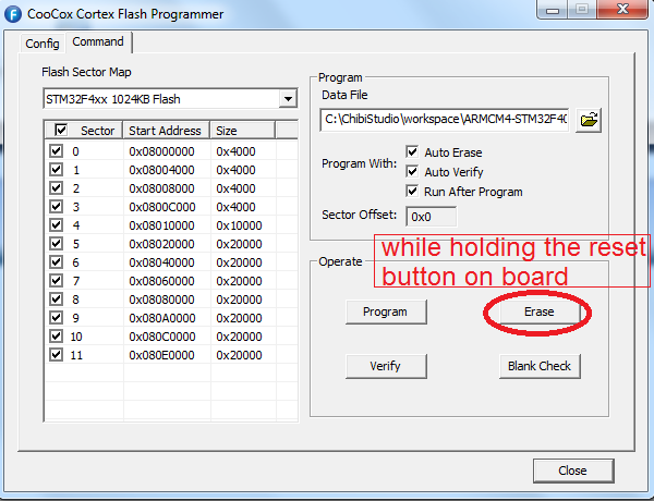

Hi Dear
Try to hold the Reset button (on board) down and during this push the Erase button(on Programmer software like CoFlash) then after about 0.5 second free the reset button I solved you problem on my STM-32F407 Discovery this way :DWe’re moving the ST Community to a new platform to give you a better and more reliable community experience.
