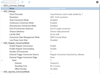

For an ongoing project I am using the ADC1 to sample channel IN0.
The DMA and sampling is working fine, but i am not sure how to set up the clockrate of the ADC properly.
The ADC is currently running in Asynchronous mode with divider 1 and the sampling time is set to 64,5 Cycles.
The clock rate of the ADC is currently set to 2.34375 MHz in the Clock Configuration.

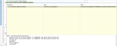

For the HAL_RCCEx_GetPLL2ClockFreq function you mean like this, right?

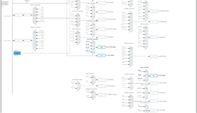

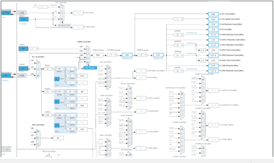

Here is an overview of my clock settings, it don't really know what causes the wrong ADC clock frequency...
@raptorhal2The ADC is only triggered once in software, then it is running in "Continous Conversion Mode" with active "DMA Circular Mode". What is limiting the sample rate with this setup?
2023-08-24 6:24 AM
Yes, and do the values in pll2_clocks match what you expect?
