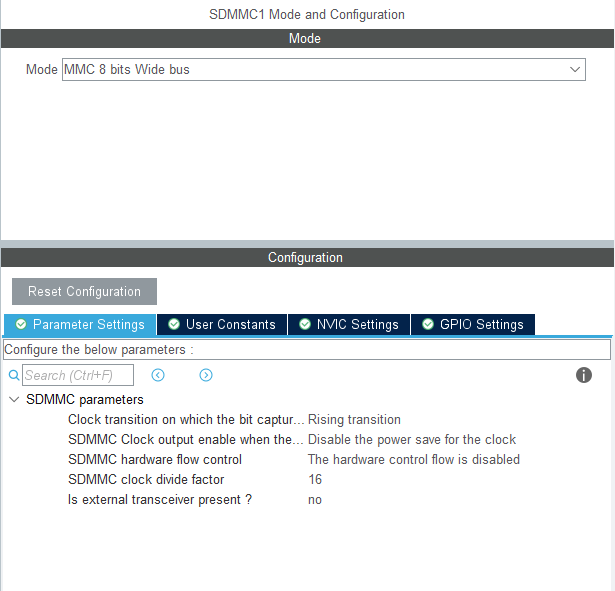

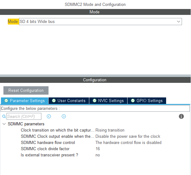

I am using SDMMC1-eMMC(16GB), SDMMC2-SD Card connected on a custom board.

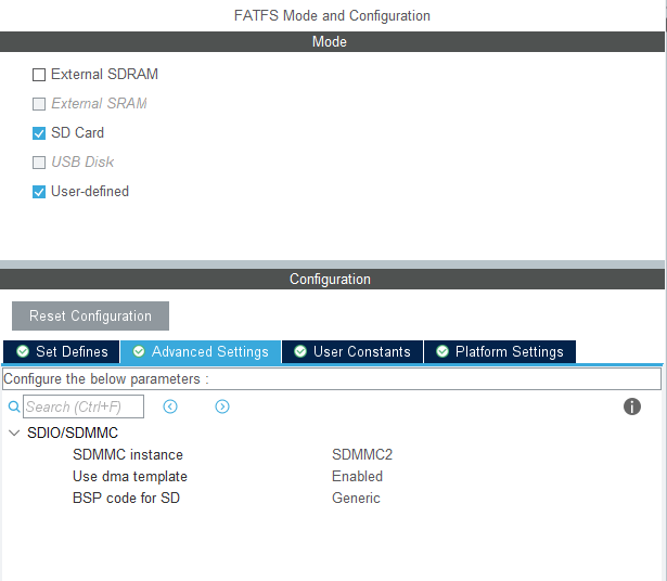

Both eMMCs and SD-Cards use FatFS as their file system.
Both work fine when used alone.
However, if you use f_open or f_write on FatFS on eMMC, you sometimes get an error and the FatFS becomes unusable afterward.
My settings are as follows.

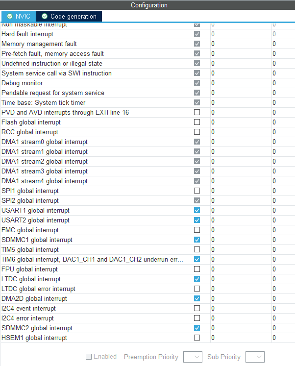

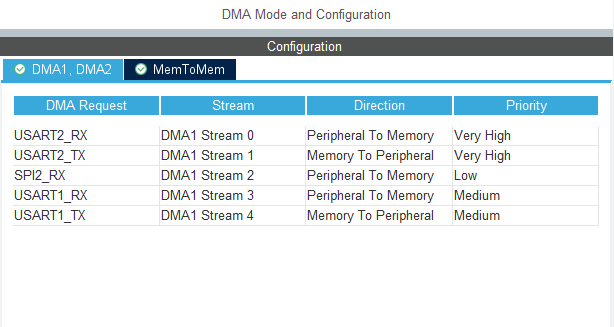

I tried to find the cause by disabling all device drivers and features and then enabling them one by one.
The problem I found was that FatFS on eMMC often caused problems if the ability to receive UART data via DMA was enabled.

The following code implements a disk file for eMMC. Note that we have not used DMA.
I'm guessing it's a cache issue with memory between SDMMC1 and the UART, but I don't know the exact cause.
Can you tell me what I need to fix?
