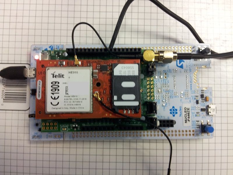

2017-05-02 9:49 AM
Here the choices are finite rather than being a cross-bar switch, and a software USART while potentially viable is generally avoided. In many respects the NUCLEO-144 is a better platform, a lot easier to inject 7VDC VIN to power board and modem.
Probably want 4G/LTE, 3G is being deprecated in North-America
