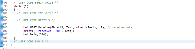

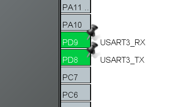

this pin configuration and code for g071

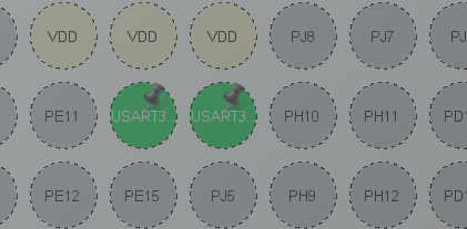

this one is pin configuration and code for stm32h750-dk
So i have done wrong? and please someone help me.

RX and TX must be crossed.
Receive must be "always on", so don't HAL_Delay, you may miss char's.
The blocking Receive you are using waits until the buffer is full or timeout, you might want to read single char by single char.
There are more perfomant but complex methods like reading by DMA, see https://github.com/MaJerle/stm32-usart-uart-dma-rx-tx
hth

Please check:
-The connection between two boards:
-Try to verify if the Nucleo-G071rb can be able to transmit data.
May be this example help you UART_TwoBoards_ComPolling.
I hope this help you.
Kaouthar
