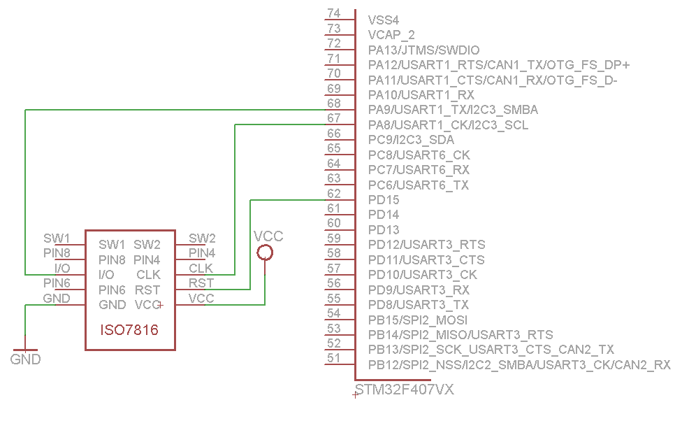

Hi, everybody. My task is to connect STM32F4 discovery Board with Smart Card ISO7816. I don't use interface ST8024CDR only hooked paid directly by the scheme specified in the image:
I tried to adapt the Cubex project to STM32F1xx-EVAL. ATR reception does not work. The oscilloscope shows that the I/O port from the map is something similar to a sawtooth signal, but more flat (on three different maps it is different). So I guess it's still an ATR.

I always get zeros. What could be the problem?
2019-04-14 9:29 PM
If anyone is interested, the problem is solved very simply. I used USART3 instead of USART1 and everything was considered successful.
