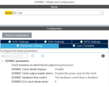

First; I have tried to setup the SDMMC interface with at least 20MHz clock speed (clock divide factor 0)
Second; I have tried to set up 4-bit wide bus communication
Third; I have tried to enable the DMA transfer using the DMA template in the FatFS settings
I got it working using 1-bit wide bus, 2MHz clock speed, 0 clock divide factor, FatFs enabled, DMA disabled, SDMMC1 global interrupt enabled.
The Detect_SDIO pin is selected (in this case input on PC6)
Using this configuration I can read, write, and format etc. However if I try to keep the settings the same, while increasing the speed above 2MHz; or changing the bus width to 4-bit, I get the errors described above. This seems to be the only stable combination of settings. This is unfortunately way too slow for my application, considering that I believe it should be able to operate at 32MHz, 4-bit wide bus; that would mean a 64 times increase in speed from 2MHz 1-bit wide bus.

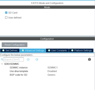

Can you send a picture of your FATFS --> platform settings?

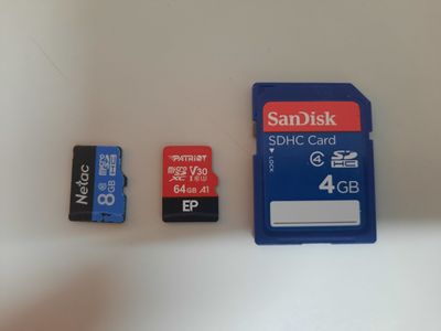

Thank you for the reply. The cards I have tried are the following:

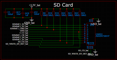

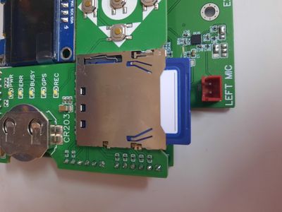

Here are the pictures of the device and SD card schematic:
This board is a 2-tier with the SD card directly above the microcontroller (STM32L431) beneath, with the signals going through pin headers. Trace (and pin) distance for signals to travel is about 5cm.
Another board I have tried, which has the same schematic for the SD card, is a single PCB (not a 2-tiered PCB as shown above), however the distance was about 15cm between the SD card and the micro (STM32L431) which I feel is adding problems to signal integrity.

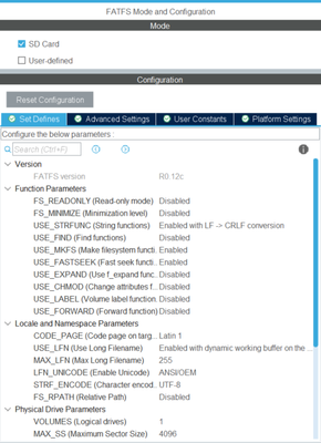

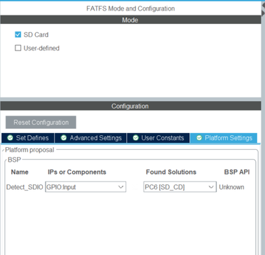

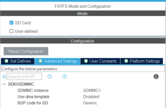

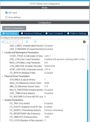

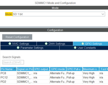

Here are my FATFS platform settings and advanced settings:

at first, set / use 1-bit mode only; (4 bit mode is more challenging with regard to signal quality )
find stable working setting then. (set pin speed medium or medium-high , not highest! , and pullups on.)
clk should work at 50M. ( i have 100MHz and div1 , so sd-card can work at highest possible speed - depending on card ! )

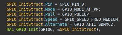

on H563 Cube force speed high + no pullup : -> sd never working.
i overwrite setting in ..hal_msp.c : to medium + pullup :
then sd working fine , with ~ 10 cm flat ribbon wire to sd card holder ! at 100MHz /div1 = 50M clk.
if you have wires, keep them together, both gnd on separate wires connected, and a cer cap at the card holder.
