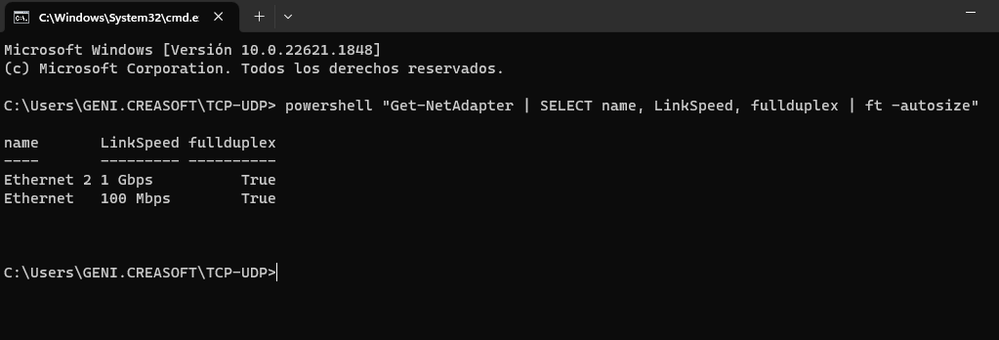

When link up is detected and autonegotiation occurres it seems that PHY is detecting that mode is half-duplex, despite ethernet_init is forcing full-duplex mode. But register has on this bit the value of a half-duplex autonegotiation result. So, here we thought that -for some reason- LAN was only able to talk with the remote host by this mode. Despite this, system communications seems very quick. So we want to be sure and we asked Windows 11 for speed and mode ethernet cards connections. This was the answer:
