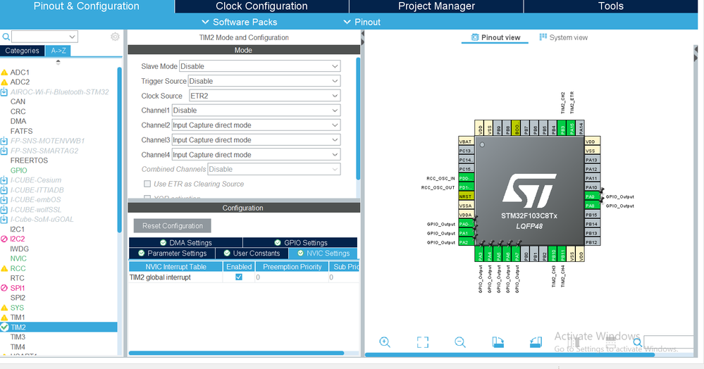

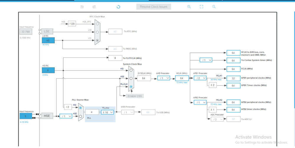

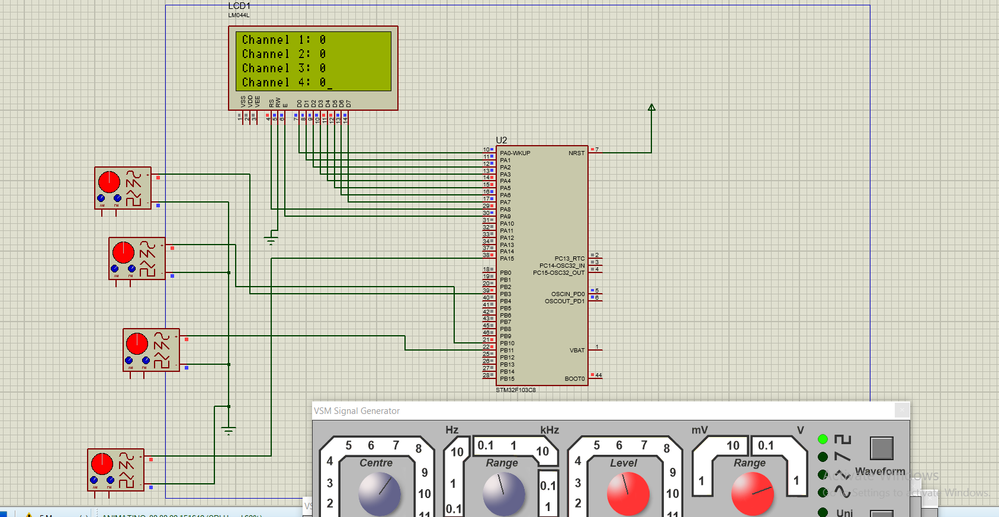

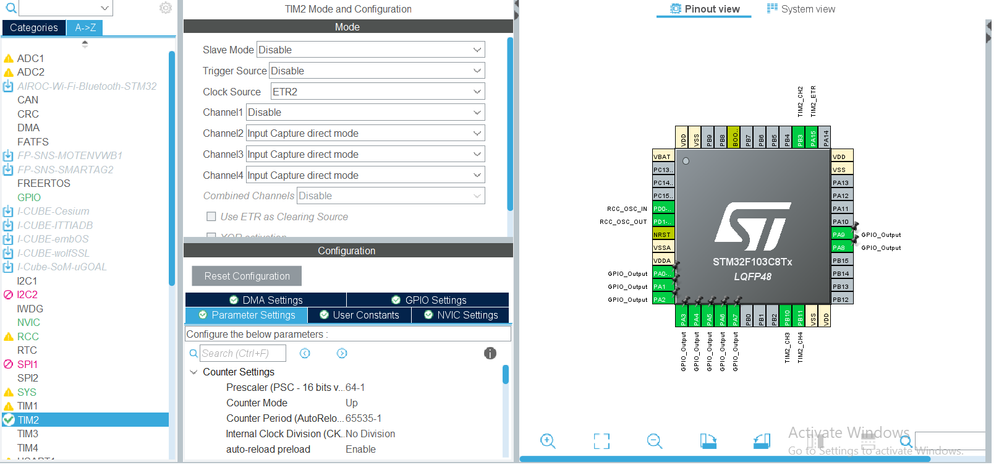

i was trying for sometime now to configure stm32 timer as a counter to count the pulses in order to count the RPM of a rolling gear and then show it on a lcd screen, and no matter what i do or change in the code or the timer configuration, the number of pulses is always stuck at 0. can anyone please help me with it? i really need it for my studies. (by the way, i am using a proteus simulation to test it).

Frankly, I'm not in favor using this kind of simulation. Sometimes it does not work but when you switch to a real HW it does.
I recommend you to use a real HW.

how you get the pulses to the counter ?
You need select the ETRx as input to count external pulses.
Or TIMxx input capture, to measure just one pulse-pulse timing and calculate speed then.

Hello @medraouf ,
As stated by @AScha.3 ETR is a serious candidate for your use case.
@medraouf wrote:
@AScha.3 i already tried that...
No one here can imagine what you did ..
You need to share your code to let community members to help you efficiently + your HW connections.
It could be an issue with your IO configuration or even with the timer itself ..

}as you can see, the pulse number is stuck at 0 although i'm giving it a pulse signal from the the pulse generator. (note: i tried the same thing but without using the timer, only the interrupts of the stm32 and it worked, but there was a difference between the 4 channels, i guess because of the high frequency of the pulses, that's why i'm using the timer.)
