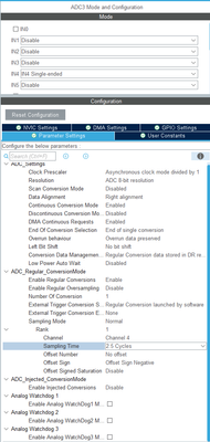

However I see there are settings as following:
So now I am confused on what settings to configure to get 5 Msps sampling frequency while keeping the CPU clock at 550 MHz.
Someone knows the best way to make sure the ADC sampling speed can be precisely configured?

you can use timer to trigger ADC sampling to set to 5Msps.
And you should set ADC sampling time + ADC conversion time less than half of period time of each trigger by timer.
