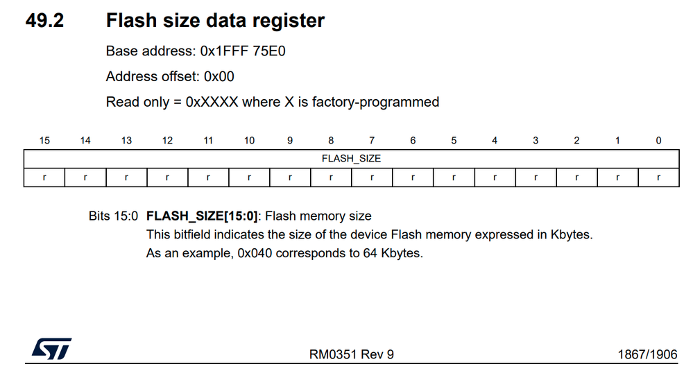

You don't need to change the firmware if it fits in the smaller flash size. The same exact code will run on both chips just fine. No changes necessary.
You can read the FLASH_SIZE register to determine how much flash is onboard.

2022-03-07 10:55 AM
