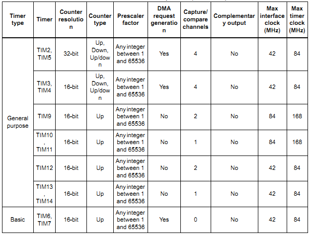

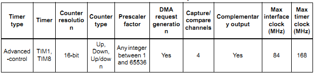

Doing the due diligence here would seem to take more time than I'm willing to expend, so I'll make some suggestions that might save you some time.
The manual for the board describes the available pins, this is going to limit your options. To do PWM Input mode you are going to need to find EIGHT timers, providing CH1 or CH2 pins. This is likely to be an impossibly high hurdle. Your post provides insufficient detail about the nature/speed of your signalling, so I'll assume it's something slow and mundane like a 50 Hz Servo, and the signals are all very similar in specification so can share a timer. I would suggest using the 32-bit timers to time stamp signal edges using Input Capture mode, where possible. And use which ever 16-bit timer pins you have available to generate the PWM Output. Use SysTick for continuous time base requirements, set it to 1 KHz, or whatever the granularity of the requirement is, have it dispatch tasks, decimate, or count off other time related events/signals.2014-08-23 3:50 AM

but why i should use 8 timers for 8 channel input pwm. i mean for example timer2 has 4 channel i can not use each channel for each input ??
Not it PWM Input mode you can't, it uses a pair of channels, and resets the timer. Review manual and examples thereof, and then explain to me how this is going to work. For a one-to-one channel to signal ratio you'd have to be using Input Capture mode. Are all the servo input guaranteed to be synchronous with each other? Perhaps you can use CH3 and CH4 to latch secondary channels?2014-08-23 5:30 PM

hi clive ,
pwmuses a pair of channels
is this because of 2 ICx signals that are mapped on the same TIx input ??one to capture the pulse width and another to capture paeriod ??in this situation it's very expensive (from hardware side),to get 8 channel pwm with 8 timers .is there another way to handle this ??(not to use input capture_pwm input) in open source projects i saw that an AVR micro controller handle more that 2 or 3 pwm input that is connected to INT pins in that micro.

As I said the channels are paired, they deliver period/duty, and reset the counter to do so.
I've also said several times you need to use Input Capture mode to time stamp the edges if you want to use multiple channels of a timer. You then need to manage the measurements via interrupts.2014-08-25 8:50 AM
well, i should use input capture instead of pwm input mode.
but i never use input capture to measure pulse width, i used it for external pulse counting .if i'm right it detect the edge of each rising. so how can i use it to find pulse width ??We’re moving the ST Community to a new platform to give you a better and more reliable community experience.
