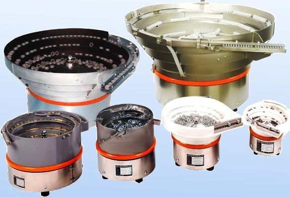

I designed an inverter for vibration tank ( photo below ) it issimply an H bridge with 500 V 20 A mosfets the frequency and duty is variable with STM32F103 the vibrator worked for 5 minutes and one of the H-mosfet blow up the L-mosfetalso show 0 resistance so it is also fried I added ( 100 nF 1 KOhm in series snubber )paralel to DS of every mosfet I suspect that there was a collision of CHN1 and CHN1N pleaselook at my code and comment if there is posibility of collision ( turn ON at the same time ) Or is there a snubber ( hardware design ) problem ? ( no software problem ) thank you

0690X00000602v8QAA.jpg #stm32
