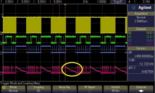

With SWD I have the same issue. But somthing isn't ok with the JTDO signal. See the follow scope picture.2012-04-16 5:56 AM

I can't explain the sagging TDO signal, and I don't think it's a ground plane problem. Most likely external circuitry.
What kind of parts do you have attached to TDO? All you might need is a 47K pull-up2012-04-16 9:37 AM
From startup I put a 10K pull up resistor for the JTRST, JTDI, JTMS and JTDO signals. And and 10K pull-down resistor on the JTCK, but after checking all that there was no bridges, and the target was correctly soldered, I started to remove the external components. And after removing the external components I get the above scope picture. The external components are not required because the target has it internal pull-up/down resistors. I read it somewhere.2012-04-17 3:38 AM
