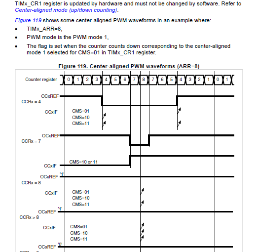

2017-11-14 7:26 AM
Hello!
It is half frequency because in center aligned mode the counter counts up and down .(normal behaviour)
Figure is from 32F4 RM.
Regards
vf
