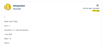

static void* data;
func ->
structure* s = new structure();
// do stuff
data = s;
return;
Callback ->
structure* s = (structure*) data;
// Error
Functions are more or less setup as above. This setup is used in many locations on the code, works just fine. But for some reason in one spot, the casting overwrites data in the structure that had memory allocated to it.

static void* data;
func ->
// do stuff
return;
Callback ->
// Error
The local "s" variable in the function has no relation to the local "s" variable in the callback. The global "data" variable isn't accessed anywhere in the function.
It's unclear what result you're looking for here, but the code doesn't do anything useful.
The GCC compiler is robust, it's unlikely the be the culprit. More likely a bug in the code.

Sorry you feel like it doesnt do anything. But like I said, it works fine for the rest of my code and is called dozens of times before it hits this error. The pointer and data is all stored correctly and is able to be accessed. The error only specifically occurs with casting to a pointer of the correct structure type.
You have silently edited your post, so yes it does something different than when you originally posted it and when I made my comment.
data should be declared volatile, since it is used in the main thread and a callback, but probably not the issue.
The takeaway is the same: it's a code bug, not a compiler bug.
