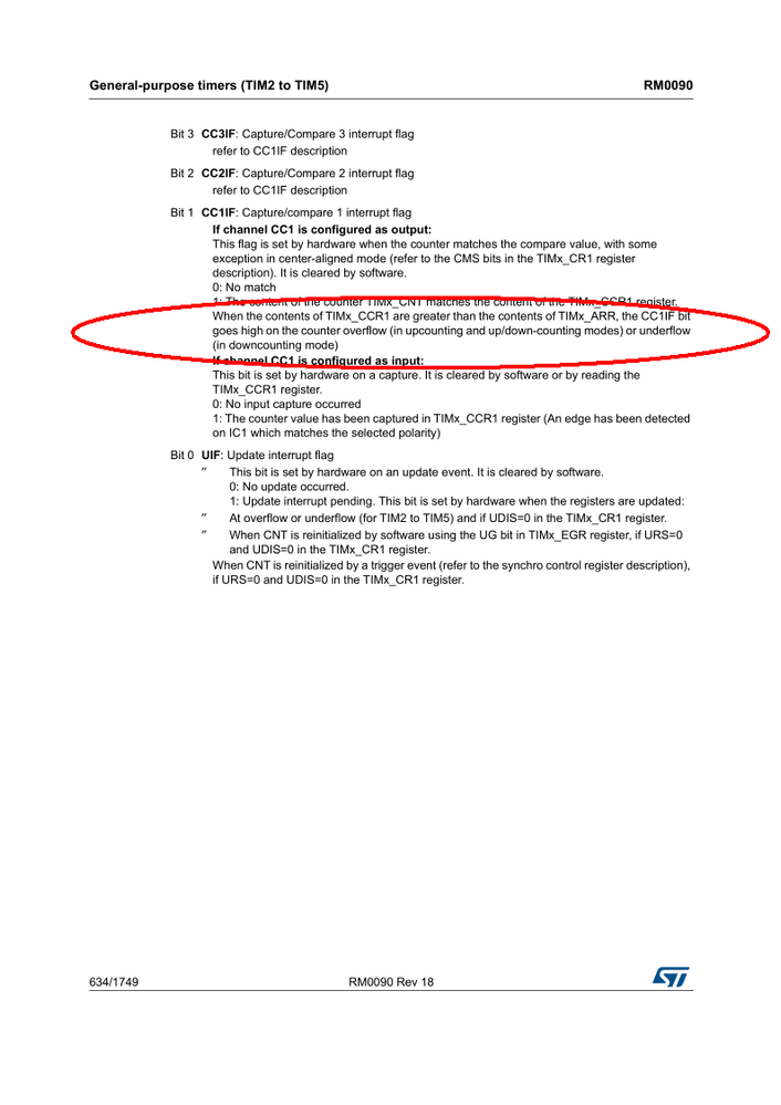

STILL I seem to not fully understand the mechanics:
If I set the the configuration to the following:
to my understanding the flag CC3IF should never be high... However it IS high after the timer has been reloaded (i.e. after TIM5->CNT == TIM5->ARR)
Please enlighten me :D
