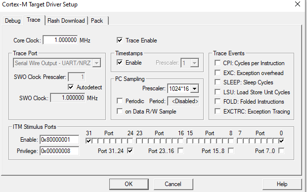

Our trace settings looks like this:
The trace seems to be running but no output.

2022-11-24 5:17 AM
The enabling code was for the ST-LINK originally, not the U-LINK, so you'd need to know the clocking, and its not 1 MHz. The ST-LINK/V2 SWO Clock was 2 MHz, the V3 I think is 15 MHz, the current DLLs might be more aware now.
Typically you need to setup the Trace with the Frequency you're running the MCU, and look at the SWO clock.
Port 7..0 should be checked too.

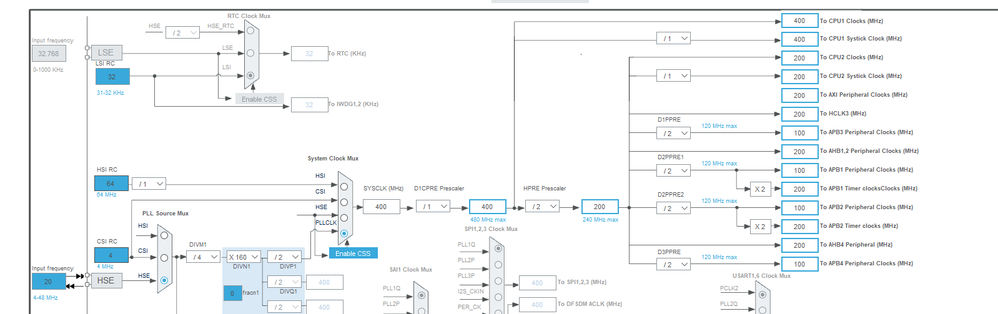

2022-11-24 7:00 AM
In the Core Clock field put the value of SystemCoreClock global variable after SystemClock_Config call (in MHz: 400000000 -> 400.0)
ITM_SendChar should work after the core clock becomes equal to that value.
Check in port 0 should be enough for ITM_SendChar.

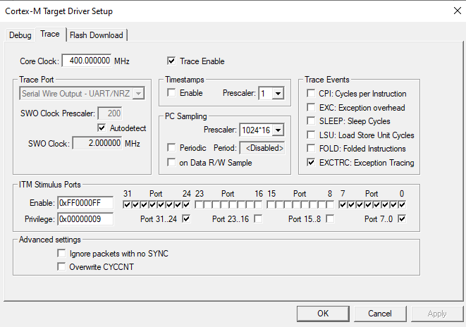

2022-11-28 2:22 AM
Many thanks for your reply. I have now done the setup as per your suggestion (i.e removed call to SWD_Init and changed core clock):
But now getting "Trace No synchronization" and also still can't see any message
2022-11-28 2:48 AM
What version of Keil?
Still suggestive of pin level connective or clock disparity.
Sorry know nothing about your design or implementation.

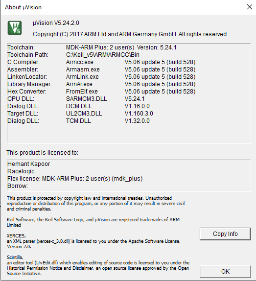

2022-11-28 2:54 AM
Below is our Keil Version
Also I have set the clock to be 400 Mhz:
We have our custom board with 20 Mhz crystal and also SWD pins are corrected to micro correctly.

2022-11-30 7:41 AM
For STM32H7 you likely have the full version of MDK. So, https://www.keil.com/support/
